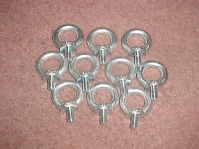

You do not want to tie down to the front end loader. You need to find a spot on the tractor itself. The FEL, even though attached, is considered a implement and not part of the tractor itself to the law men.
I actually took out 2 bolts in my tractors front end and got 5/8" lifting rings rated at 4,400# each.
Chris
Chris
That is what I use on my JD 2305. Except I use 1/2" because it is all I could find. Where did you find the 5/8" lifting rings?
Phone company. My buddy works there and he was installing large cabinets on neighborhoods for U-Verse TV and they take them out when set. He gave me about 25 of them. I have used them for a little bit of everything.
