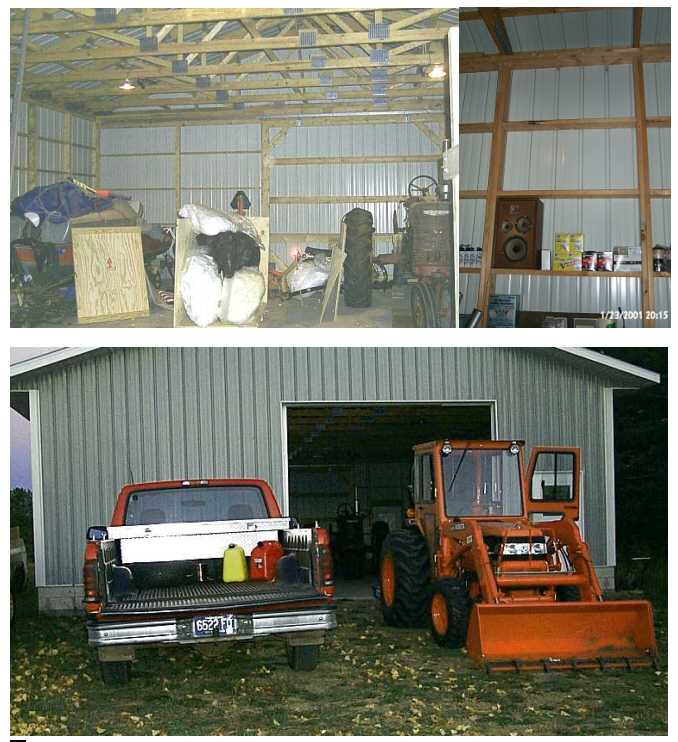

I've got to let you know about the "hybrid " pole barn that I had put up...it is a pretty neat way to construct this type of building. This would be easy for even one person to prefab the 'ladders' and I really love the "built-in" shelving.
First of all , it has a concrete floor (not entirely necessary) and then 2 courses of block to get the wood away from the ground and a 2x6 base plate. You don't need treated lumber this way. The walls are built with 2x6's in 4' sections that are like ladders. Verticals 48" out to out and horizontal "steps" 24" on center. Then the ladders are raised onto the base plate and nailed together. The double verticals where 2 ladders are joined are the supports for the roof trusses. When the roof trusses are only 4' on center, it results in a nice strong roof. The horizontal ladder "steps" are the nailing surfaces for your siding and act like built in shelves on the inside.
I had the site prep done and then I had a pole building contractor build it for me. They showed up Monday morning and poured the floor, put up the block and started making the side walls. The next day they put up the side walls, the roof trusses the roof sheathing and started on the side wall sheathing. On Wednesday they put up the gable ends with the sliding 12' doors and man door at each end and finished the job as it was getting dark. They even painted the trim and wiped their fingerprints off the metal. The building is 32' x 48' and the building construction was about $12/sq ft with site prep and electrical extra. I called around and got a wide difference in pricing, but these guys were not only less expensive, but returned my calls right away, had a contract ready after giving me a phone quote and came on the day they promised and finished in 3 days. It pays to ask around!
You can see my cheap lighting - 4 chicken brooder heat lamps with regular 100 watt bulbs. That's my old Farmall M inside and the new Kubota outside (before the snow). In snow country, it is best to keep your doors in the gable ends.
Pat (Techno-Tractor Mom)
