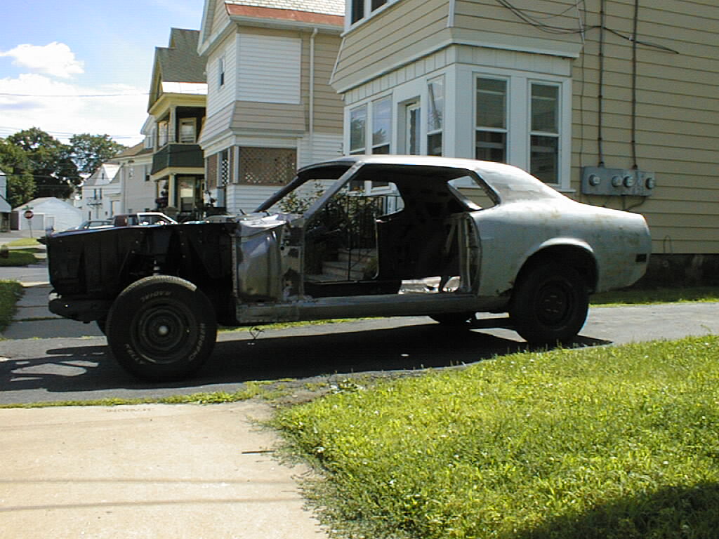

70boss,
From your name I see we have more then tractors i common. see att.
   / pole barn #49
whew, you sure know how to bring back old memories; i had the pleasure of havin a new 70boss; wayyyyyyyy back when....grabber orange...white interior;
heehaw
