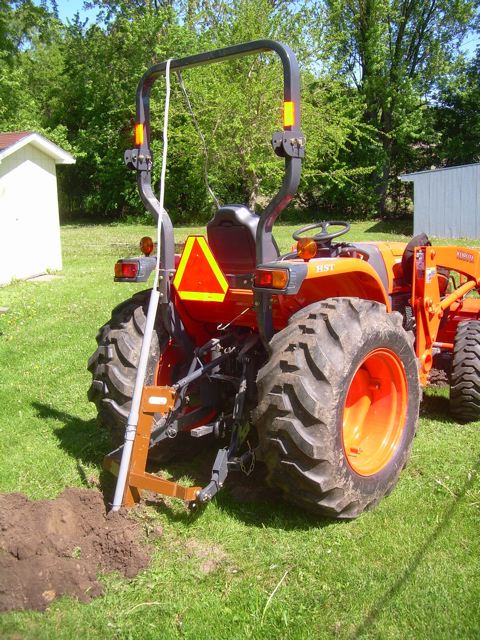

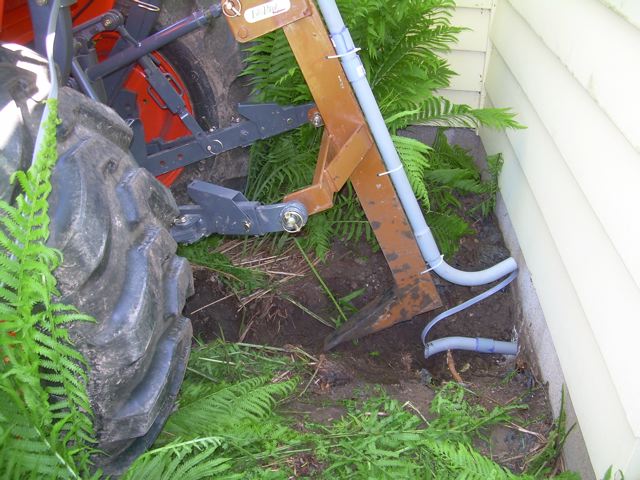

Subsoiler is not too narrow. Do some searching as this has been covered several times before. Previous posters have used black plastic pipe as it bends and holds up better as it is flexible. If you do it, use a piece of conduit to run the plastic through. 12" seems kind of deep, but maybe you have some specific reason?
Wanted to add that the following pictures are not mine but the result of others' postings over the years. You'll probably uncover several more with searching.

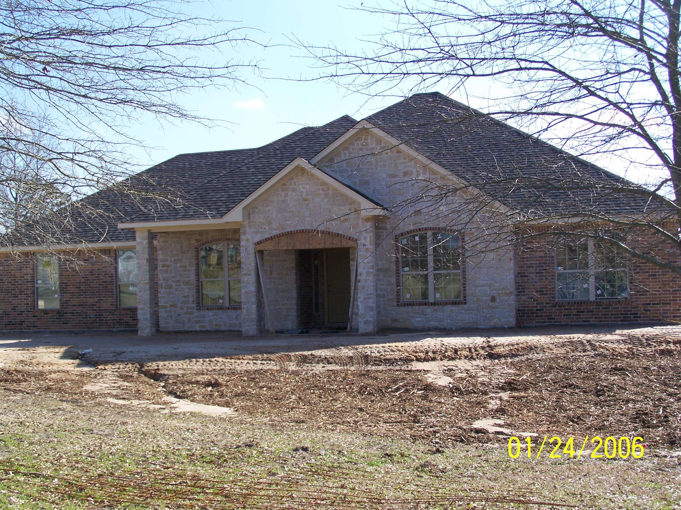

Here is a little more info, that I should have provided up front I guess.... We built this house starting last January and moved in in July. The land was pasture land for decades and had a 5ft fall in 70ft. We hauled in 110 12 yd loads of red select for the pad . It was compacted as it was layed in. So, all but the surrounding house pad is good old east texas sugar sand that is about 5 ft deep in most areas before hitting clay.. The existing grasses are coastal , bahia,and weeds. We will be starting over with bermuda and centipede mix.
/ smaller furrow for pvc
#12
Red select is prime red clay dirt. It is the best pad material in this area chosen for its compactability and stability.....its almost like concrete when compacted.
