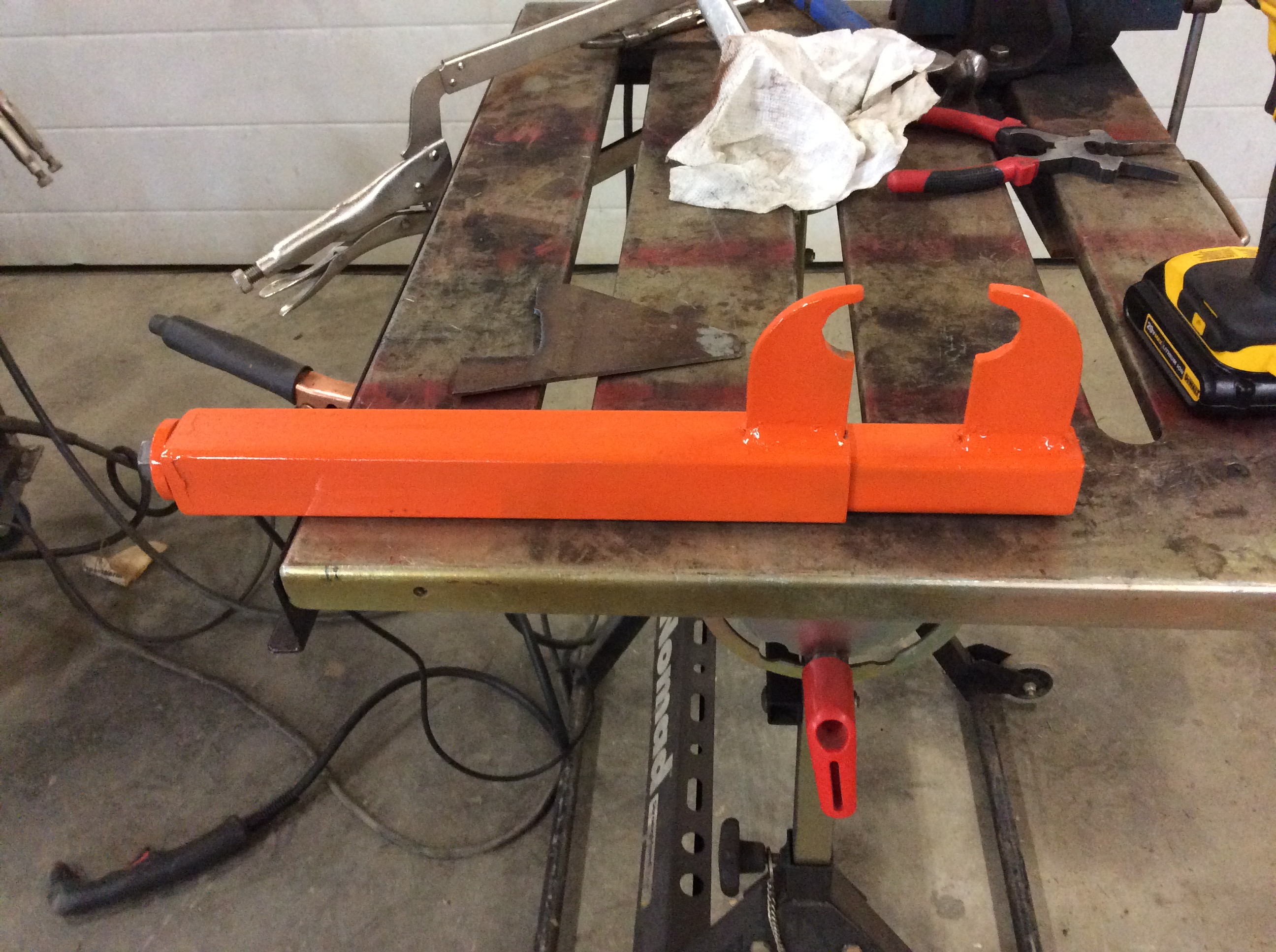

I finally got around to making one of those chain tighteners. I had all the materials laying around, so the cost was basically nothing other than my time. I suspect I will appreciate it when I need to install the new Trygg chains.
   / Trygg chains installation #53
Nice work..... even painted Kubota orange!!
The tool will be a big help
Dave M7040
It was the pics you posted that gave me the inspiration to make one and the bright orange color will make it easier to find in my messy shop.:laughing:
Thanks for posting those pics.
John

Nice work really neat ! What size of threaded rod are you using ? I might want to build one myself someday. Probably painted red :laughing:
I just winged it and used 1/2" rod.
I'm pretty sure the chains don't care what color you paint the tightener,lol.

Ok nice. That tool is going make install easier for sure, wish I had something like this when I installed my chains.

Seems like you could use a high lift jack to tighten chains pretty easily.
   / Trygg chains installation #59
Before investing in the TRYGG tool I tried all sorts of other stuff. Pipe clamps, bar clamps, ratchet straps........
You need a tool which you can swing out of your way while still maintaining the tension.
Wrestling with a heavy jack might be fine for someone young but.........
