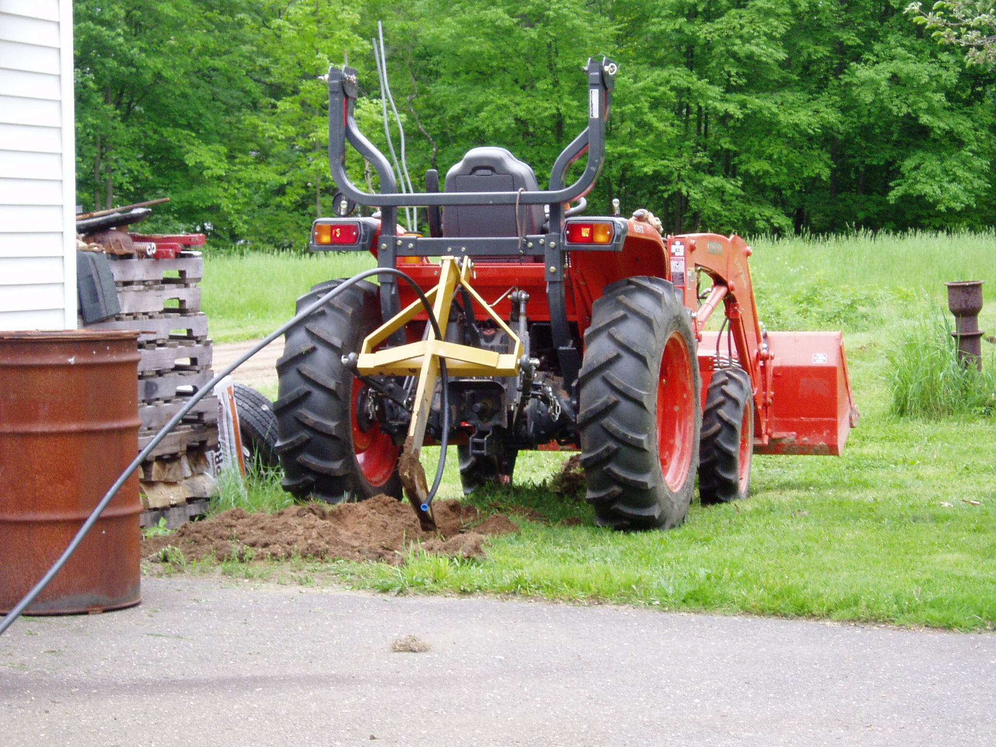

I found the standard subsoiler point worked just fine for 1" or 1.250" line:

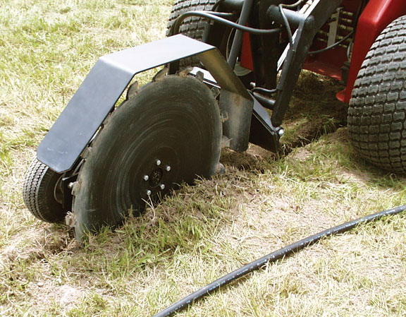

This what I use for trenches. It is a hyd motor turning a 26 in carbide tipped wheel. Does an outstanding job.
You could make something like this with a hyd motor, blade disk, and carbide teeth. Mount it on the bucket , 3pt or make a push/pull trencher.

Those would be great if roots were an issue. Looks like the miniature version of what Vermeer makes to cut pavement. Nice!

Is that the powertrac stump grinder?

Yes, it is a stump grinder/trencher from the early 90's
