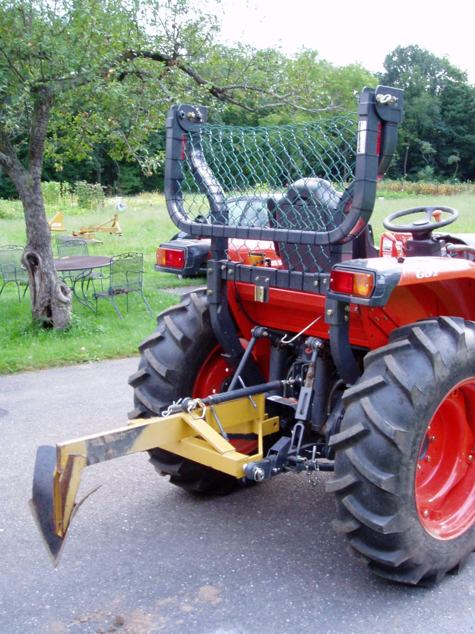

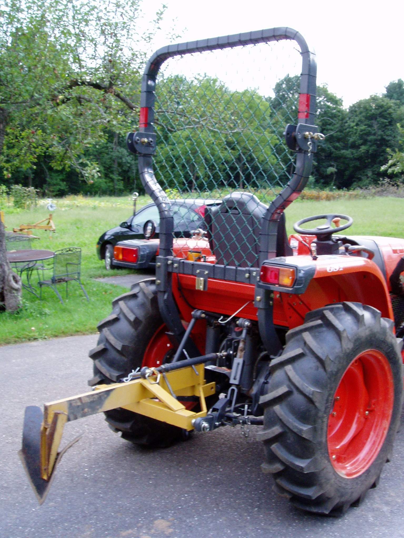

I once tried breaking the roots on a stump with a 3-point-mounted plow--not a subsoiler-- and quickly learned the importance of having the pulling point below the axle. Currently I'm removing stumps, most freshly cut but some old; maximum diameter 15"; mostly water oak and black cherry, but some live oak (tough!) and yellow pine. The tricky thing on yellow pine is a very strong taproot. I've been using a backhoe on a Massey-Ferguson 1635, and it's a good deal easier and more certain than trying to pull them. Doesn't take exceptionally long--most of the process is repeatedly tearing at the roots until they break. Longest I've spent was one hour for 2 water oaks, a cherry and a 4X4 all clustered together. I am working in sandy soil. Another option for cutting stubborn roots once the dirt is pretty much cleared away is to use a Sawzall with an aggressively-toothed blade.

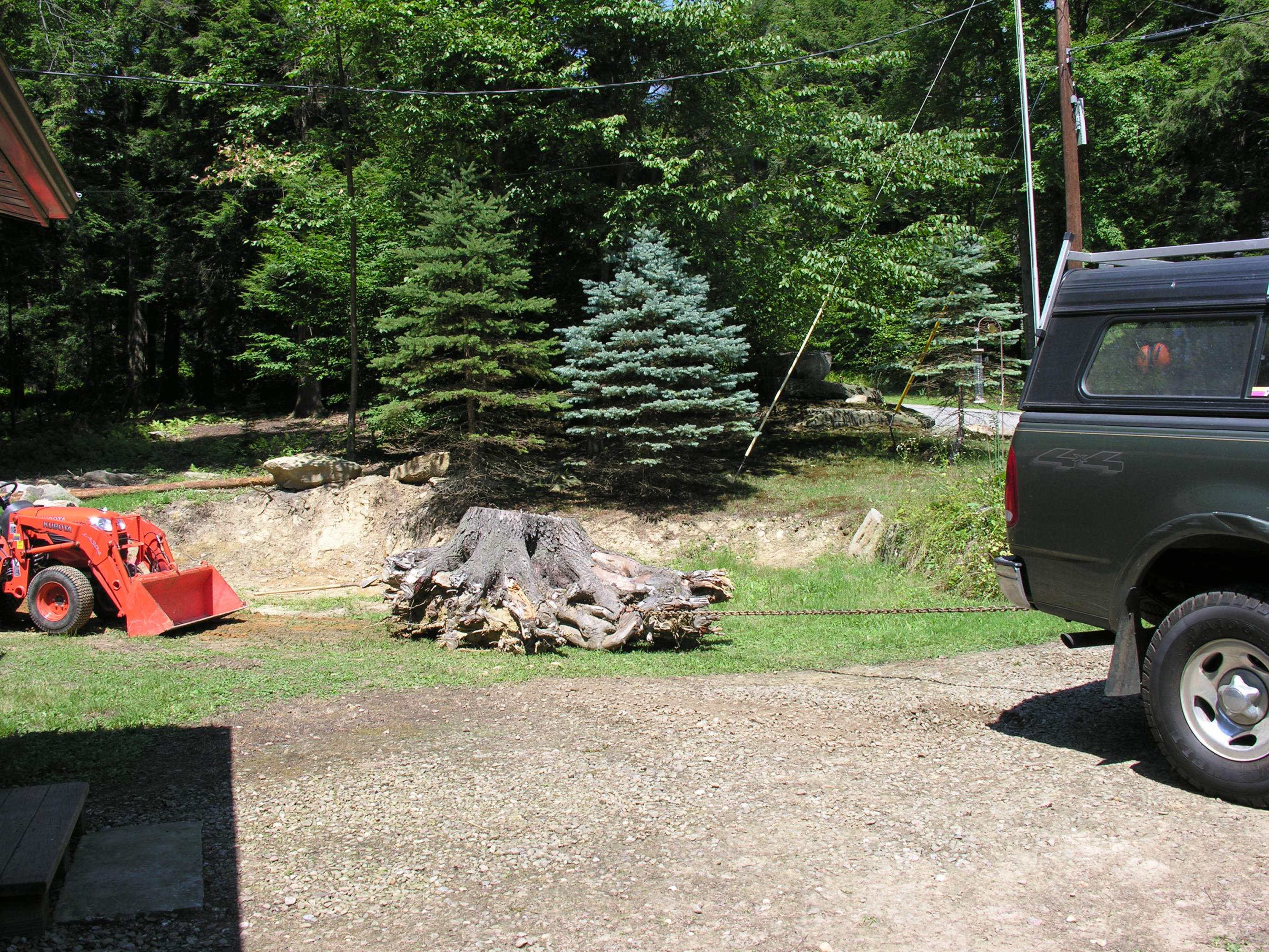

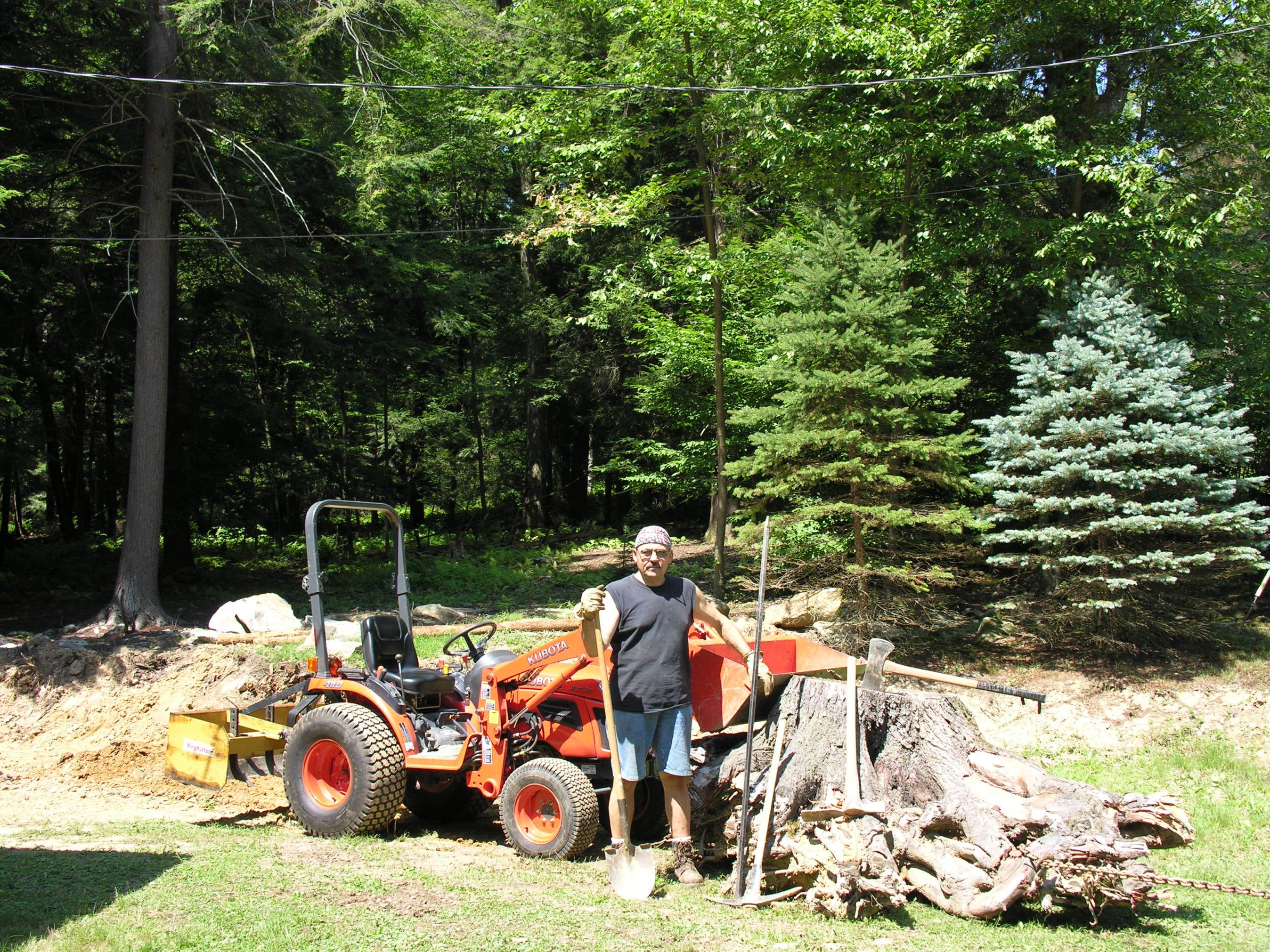

I removed this stump by digging, with a pick and shovel, all the way around and cutting off the roots with an axe. It took pulling with my truck and pushing with my B2320 to get the stump to where I could pressure wash off enough dirt and clay to flip the stump over and remove the rest of the dirt and clay. It was then easy to drag the stump the 200 yards to my stump pile with my tractor. BTW The stump is eastern hemlock about 30" in diameter.

THAT is a stump!
   / What Bends/Breaks First :) Stump pushing or pulling... #47
Thumbs on on that stump!..attaBoy!

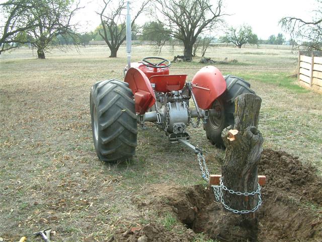

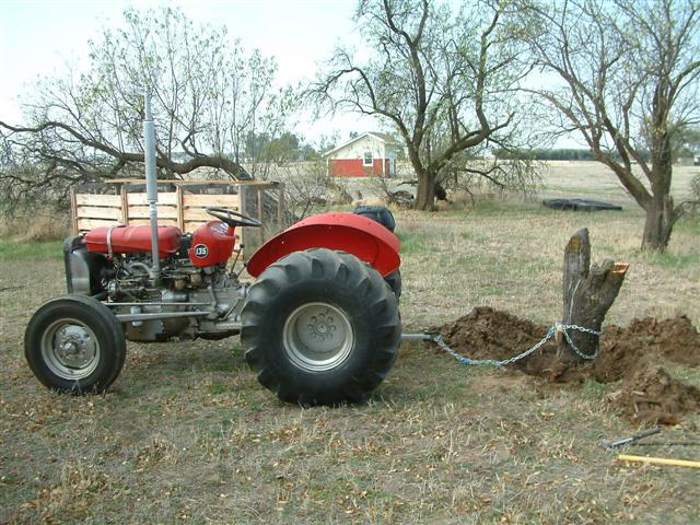

Here's how I removed some old stumps in my almond orchard with my 1964 Massey Ferguson 135 diesel (45 hp engine, 37 hp pto, ~33 hp drawbar). Those big rear tires are loaded with water for increased traction.
No way I could pull that stump without a lot of preliminary digging and cutting the horizontal roots with an ax or chain saw. Even with that preparation, I had to jerk it a few times to loosen it and then I could extract the stump with a continuous pull.

The previous owner modified a 135 field tractor for use in his olive orchard. Replaced the 28" dia rear rims with 16" dia rims carrying Goodrich 6 ply 18.4-16A rubber (like you find on combines or self-propelled swathers) for high floatation and low squat to work under the tree branches (mowing, discing). The front axle spindles were shortened to keep the tractor level.
It would be a great tractor for mowing steep slopes with its low center of gravity--but my 10 acre place is flat pasture so I don't get to enjoy that experience:). But for folks with mowing jobs like that, this is an easy way to convert a tractor to do that work more safely.
