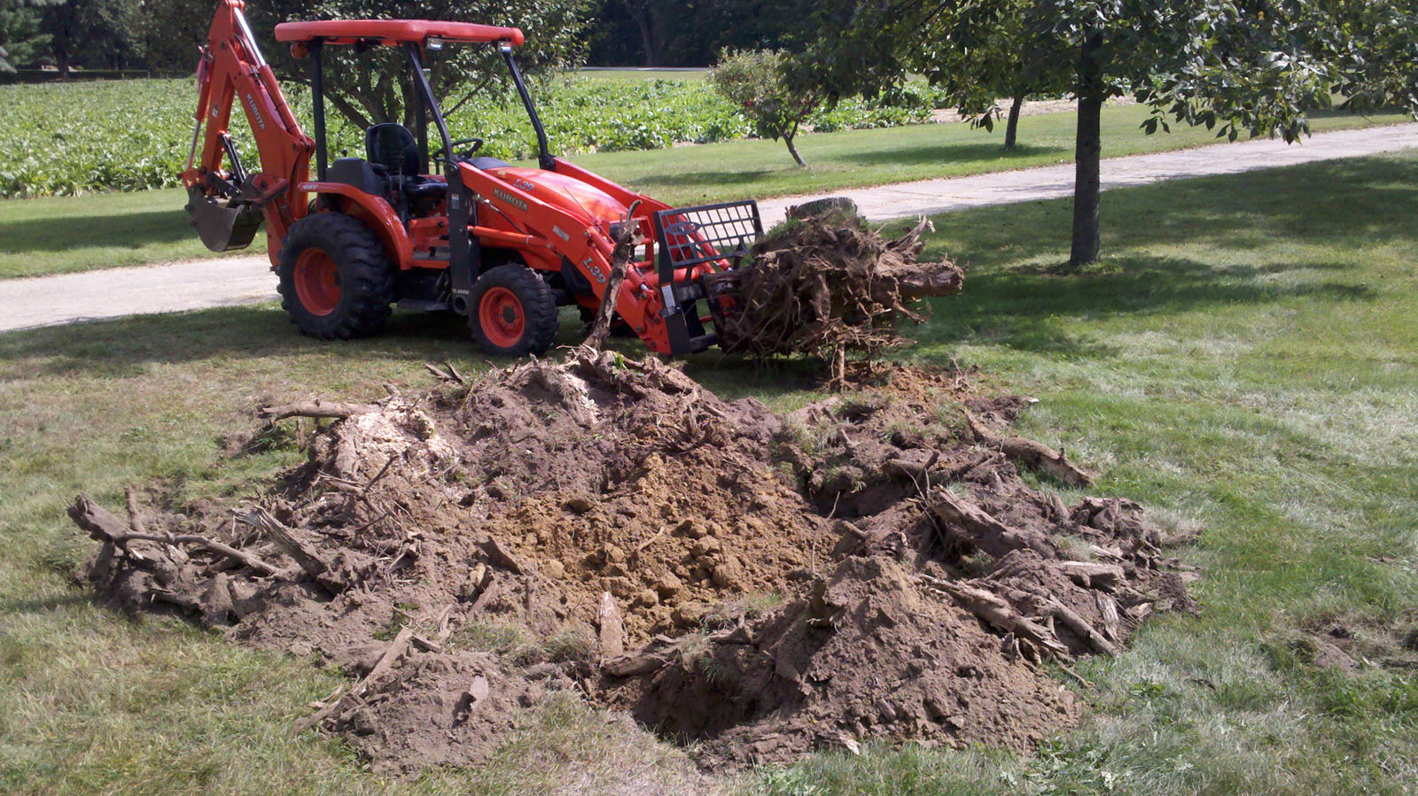

Here's 16 inch Ash stump that I dug out today. It has been dead a couple years - Emerald Ash borer. I had left a six foot stump on and I tried pulling it before digging and it would not budge. It didn't take long to break the roots with the backhoe and get it loose. I used the thumb on the backhoe to pick it up out of the hole after it was loose and set it on the ground so I could pick it up with the forks. It took a lot longer cleaning up the roots and leveling the hole afterwards.
With as may stumps as you have, if they are not rotted, I would rent an excavator for a day (get one with a thumb) to dig them and then haul them away with your tractor.
