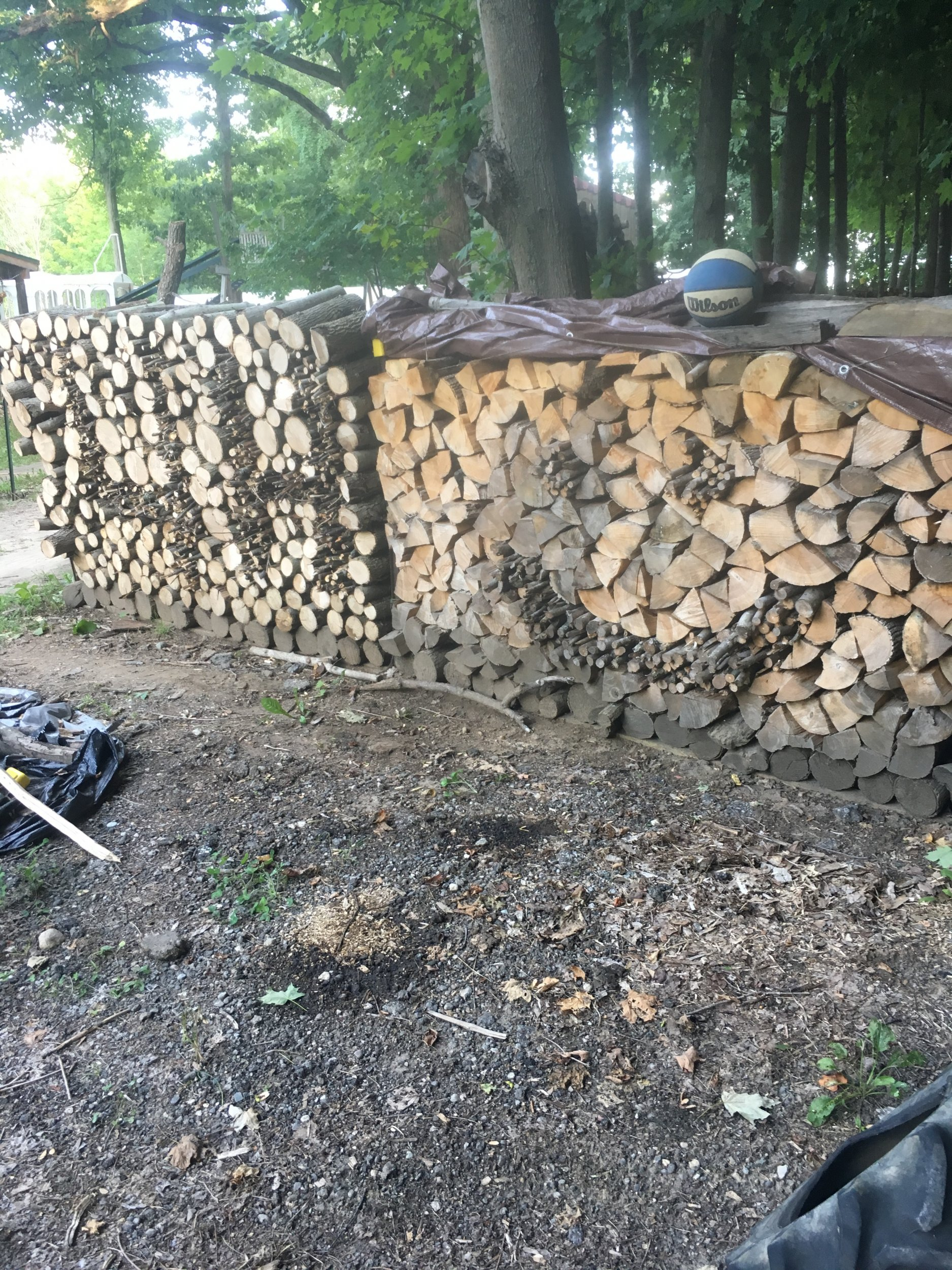

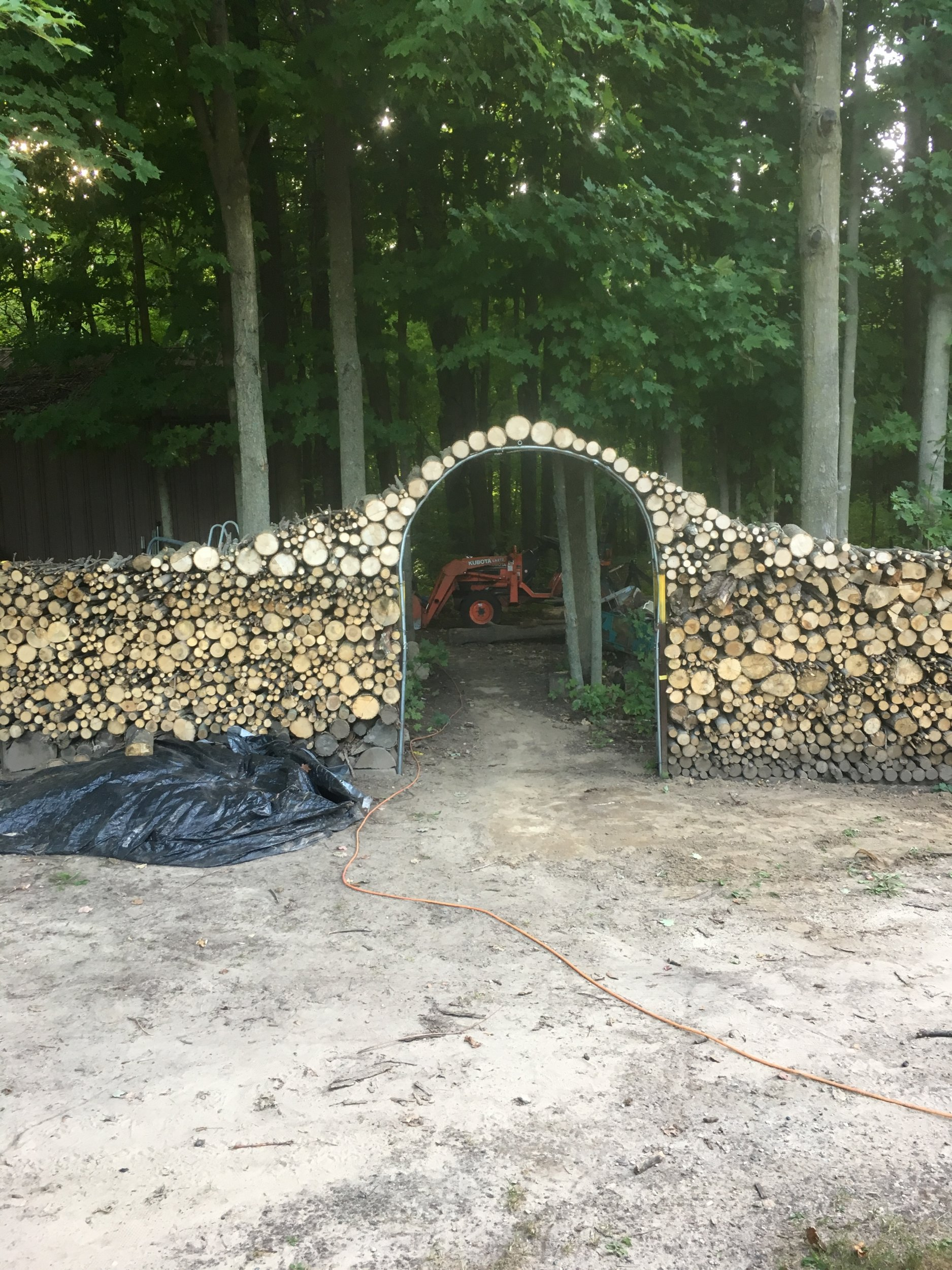

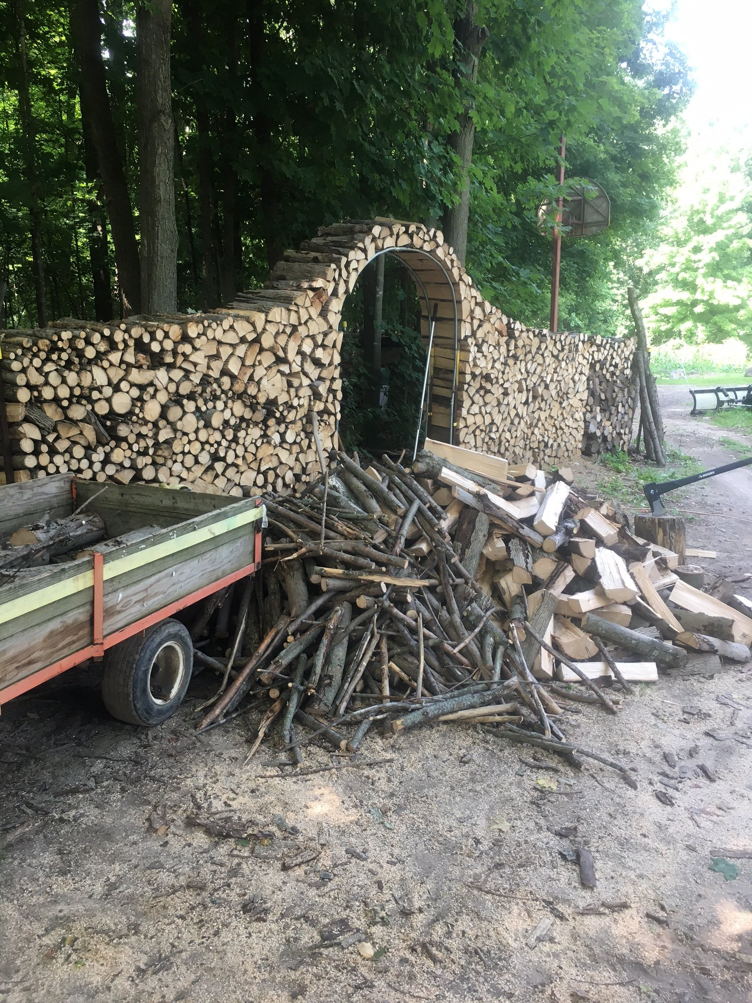

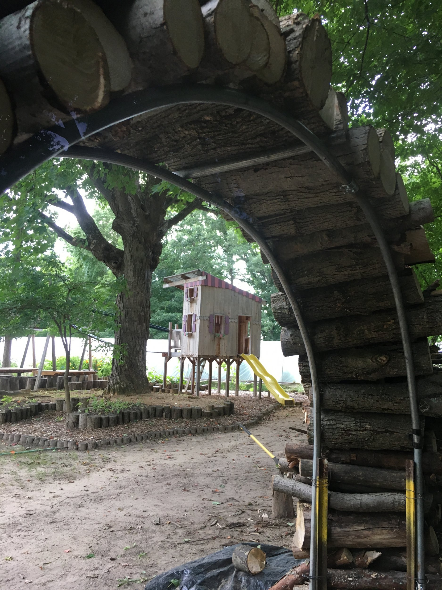

If you have health issues use a splitter? Maybe, but I think many machines promote obesity and health issues with many of us. You spend a lot of money to still lift and stack logs and physically move them out of the way, then to move more logs out of your way all around a big noisey machine. I prefer a 4 pound, $40.00, splitting axe for many reasons, here the top 10: 1. Faster than most hydraulic splitters. 2. No yelling while working. Shouting over motors moving wedges is dangerous. 3. Most who have splitters use 2 people to do a one person job. 4. Teaches you to read your wood which comes in handy for felling trees and bucking logs stuck between trees in the woods 5. Absolutely great cardio and general exercise. If you can't split with an axe then why get a splitter? 6. Grandkids love trying to outsplit grandpa creating healthy, quiet outdoor family time. 7. Quieter by far and non-polluting, no breathing fumes. 8. Listening the the whack of a log splitting around an axe head and thumping the splitting log in early morning, a one of a kind sound (I tap log, lift, flip over and let weight of log hitting axe on stump split the log). 9. It heats you up doing the work, true heating you 3 times. 10. Satisfaction of the fruit of your labor, heating your house for the winter. View attachment 715756
Showing how arch was made.
Part of 4 full cords of wood, used as a privacy fence during the year.
Gate to the barn, EMT tubing lashed to t-posts.
I LOVE THOSE ARCHES, SO COOL!!
That being said.., I mean Zero offense by this, but it looks like you have WAY too much time on your hands. I unfortunately DO NOT so I am forced to use one of those noisy, fatty making machines.
