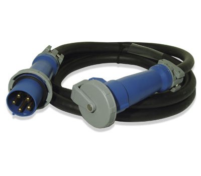

This is exactly what I need but it would appear that is not approved in the Province of NB.....
Will probably end up with a double throw 3 pole switch that is ratd for exterior.
The Gener-link is the among the simplest and economical methods to power the entire electrical service with up to 10 or 12.5KW of power. Even includes a 20ft power cable. Max rating is 40amp per line. Probably the easiest unit to satisfy electrical inspectors with too.
The sliding interlock bolted onto the face of the existing breaker panel is probably the cheapest if there is a way to run power from inside to outside the house. More capacity possible too above 40amps.
