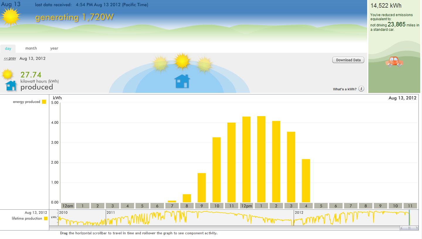

We have been bumping 32KWh for the last three months. Our 5KW system, has us hitting net zero for the year. We're an all electric house, but do a lot of heating in the winter, with a wood stove. solar.JPG
I have seen hinted, that many are comparing just todays electricity rates for the payback. Electricity rates keep rising, so the payback times shortens.
