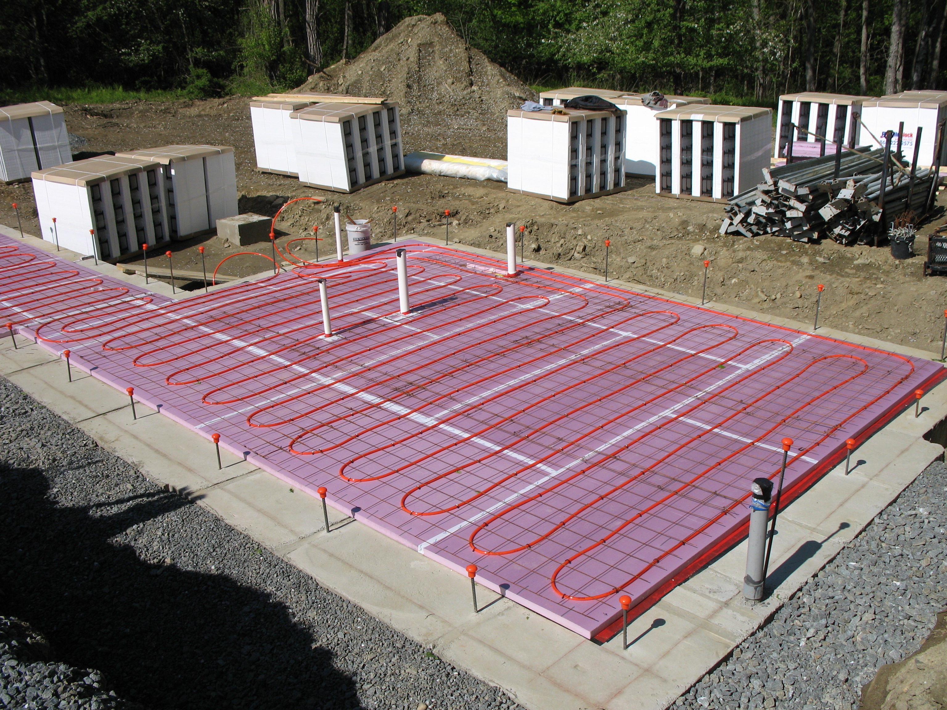

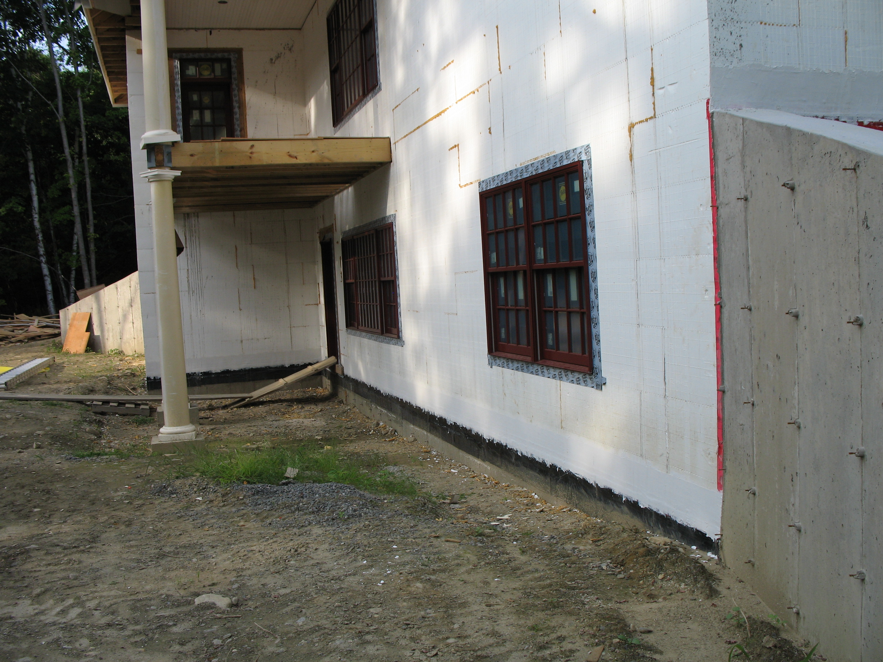

DRIP LINE - My wife and I built an ICF Home back in 2013 using the Build Block Product line. Have you decided how to finish below the siding to grade. I discovered a product sold at Menards called Styro Industries Tuff II White Foundation Coating that is made for ICFs and really does a good job. Below grade I was a bit ****, I first installed Tamko Peel and Stick Membrane then ran a full length sheets of 15 mil Stego Wrap from the transition point above grade all the way down to the frost footings. In the 4380 PIC you can see the peel and stick over the ICF block and then I used the Tuff Coat to cover that seam and up another 1 ft above grade that was hidden behind the siding. My wife and I also installed Owens Corning FOAMULAR 400 Extruded Polystyrene (XPS) over the aggregate between footings and stapled Pex on top with welded wire mesh.
