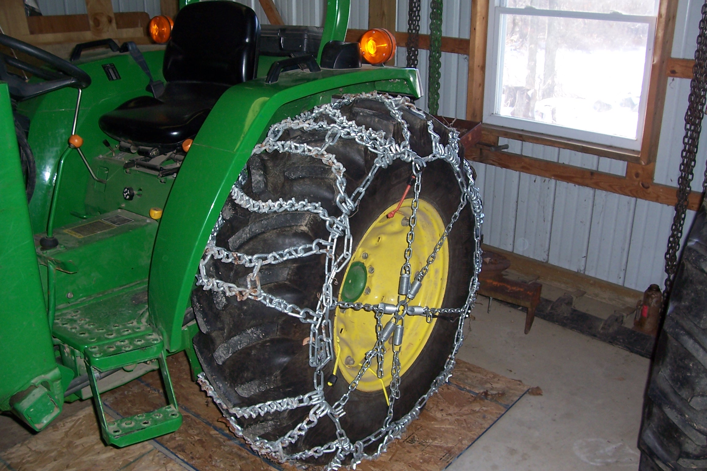

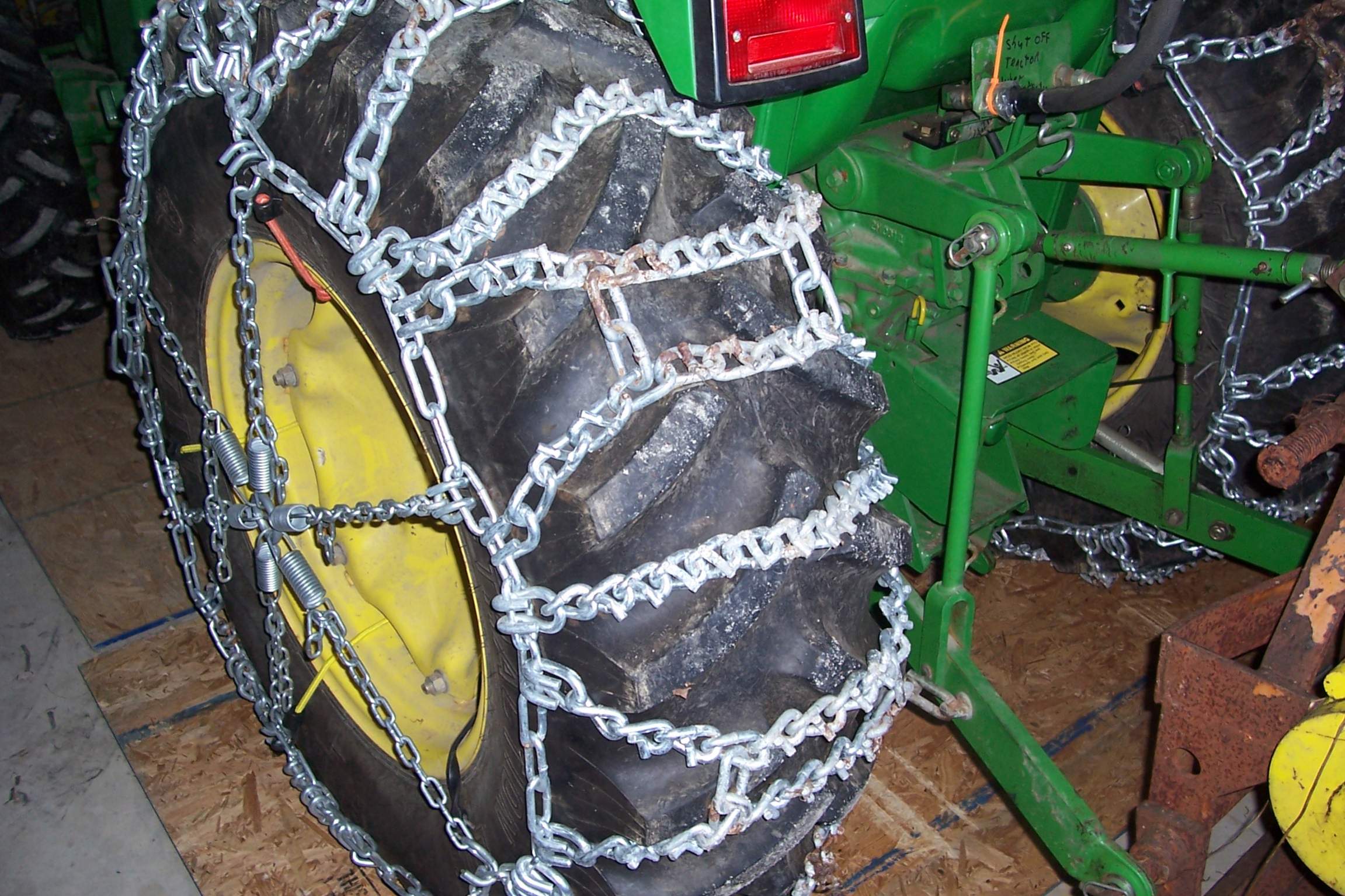

The duo grip chains have great traction, but they really ride rough on any kind of pavement. I bought some, and wouldn't do it again for my use. Since you usually don't get them in sync side to side it's like riding on two oval wheels that are out of time.
/ Rear chains #28
Won't any chain above the lugs cause a rough ride? Double ladders may be smoothest for R4s, but I'm not sure they would work for R1s. Chain patterns vs tire types
These might, however:
/ Rear chains #29
/ Rear chains #30
Mine are not rough, because the chains are so closely spaced.
