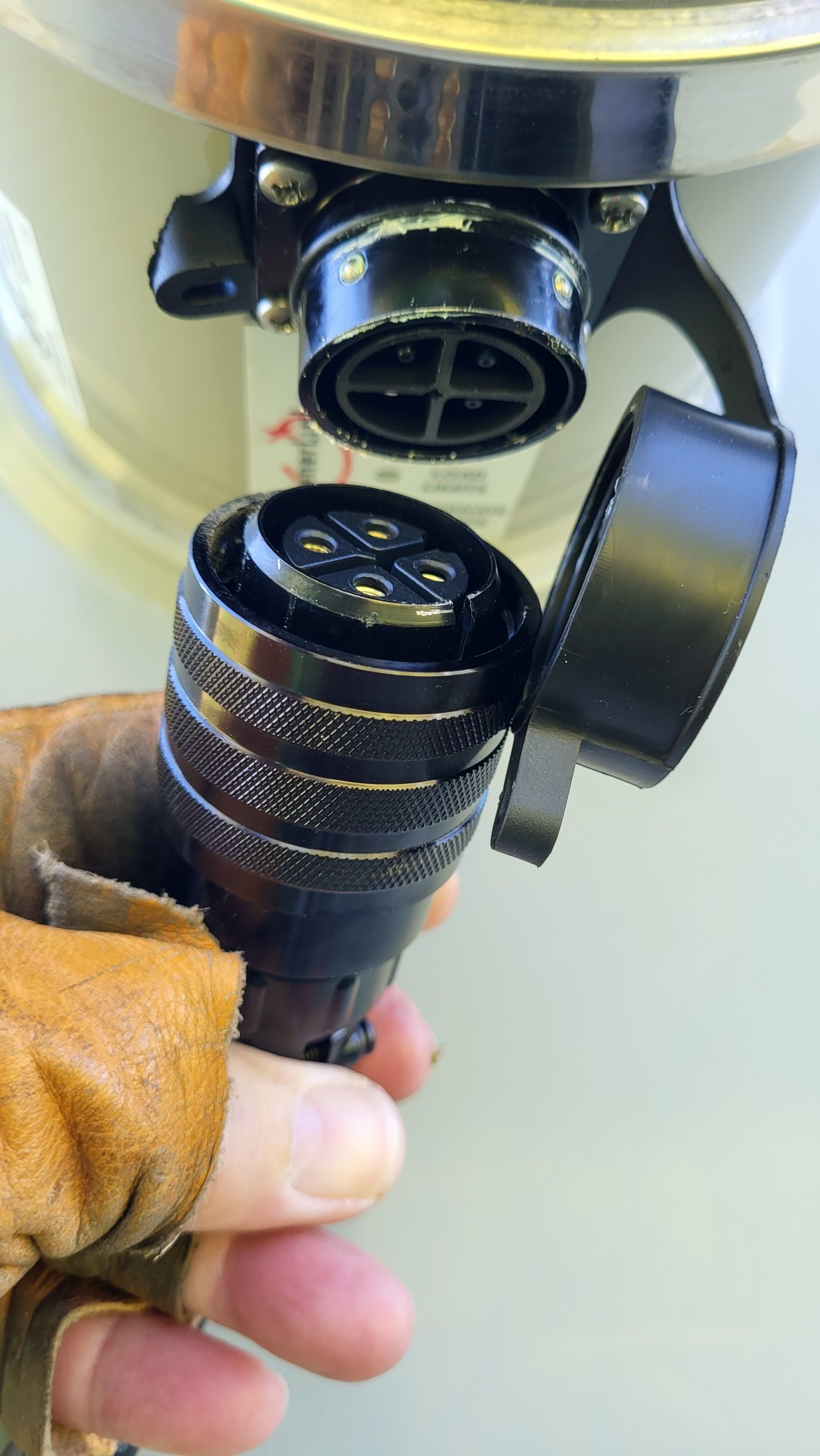

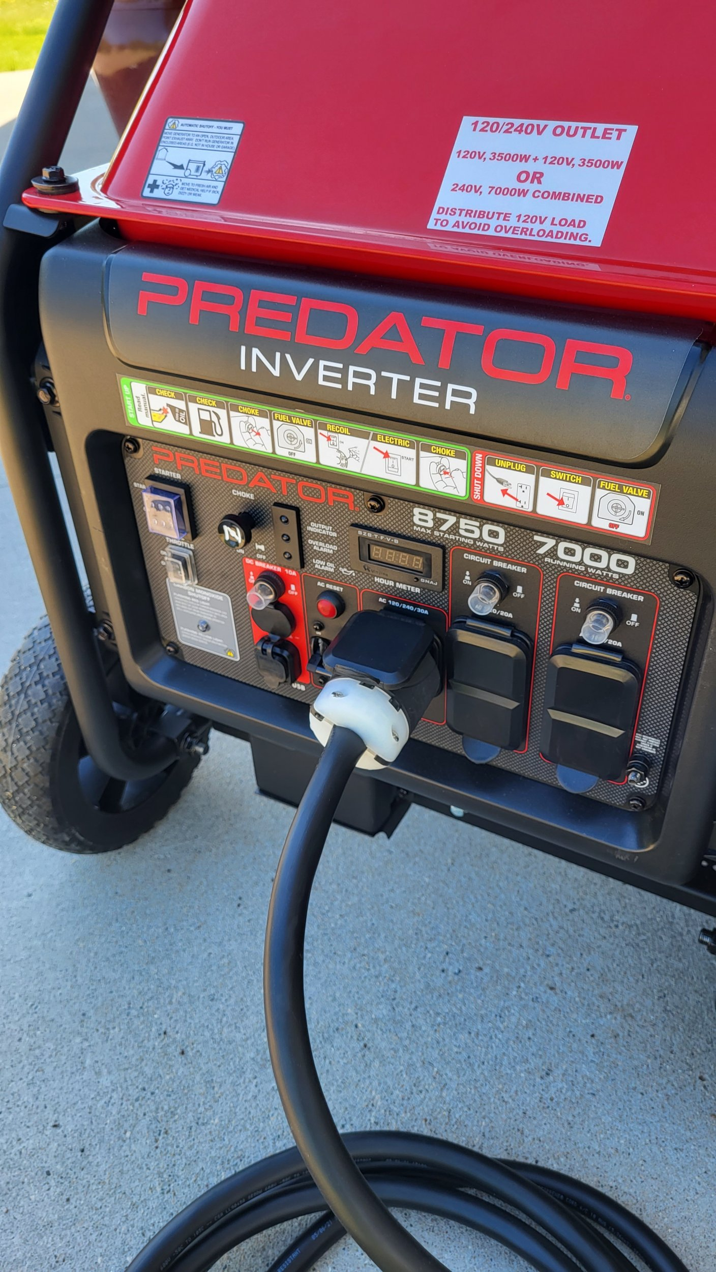

I've attached a few pics. I use a Generlink for my automatic transfer switch, as you can see in the pics. I just had it installed (my electric co-op did that for me) a few days ago. I used the well pump as a test load....was very happy to hear the generator grunt just a bit when the water pressure tank emptied enough for the pump to kick on. :)
