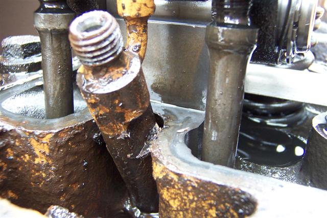

Thanks for the help. I have Lubriplate Assembly Greese for the bearings and I'll use plenty!! The Diesel fuil in the oil filter is something my Dad came up with when changing engine oil. He said it's good for flushing out the system, but I'll just smile the next time he suggests something like that. /forums/images/graemlins/grin.gif
Before I brought the head down I decided to remove the exhaust manifold. They less they have to do the less I have to pay. Half the bolts were rotted half way through, but still holding. I broke off the heads on some, and others I had to grind off. I got three out of 12 out by just turning them. I was able to get a few of the busted ones out, but still need three of them drilled and taped by the machine shop.
