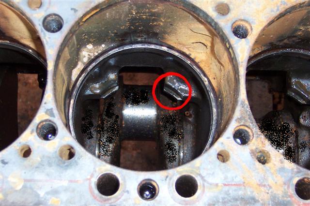

I picked upt he connecting rods today with the new bushings in place and hone out. The difference is HUGE from the fit of the old ones to the new ones.
I think I have a theory as to what happened with the engine.
The bushings were worn to the point that I hade play in the wrist pins by hand. I could wiggle the pins around in the bushings. The new bushigns are so tight that you have to get the wrist pins perfect for them to slide in.
Would slop in the bushing allow the piston to wobble around in the cylinder? I think so. Would this cause massive tapper and excessive wear? Again, I think so.
All cylinders had too much taper, but five and six were really bad. One and Two had new pistons in it, but the same slop in the bushings.
If the taper gets to a certain point, will the rings break?
This is what I think happened to my engine.
The picture is what the new bushings look like.
Eddie
